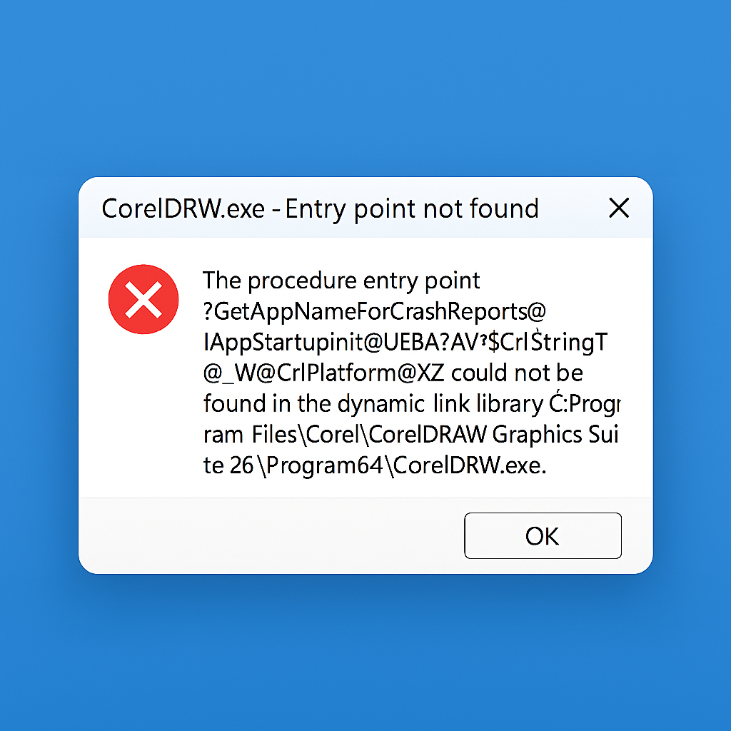

You attempt to launch CorelDRAW and before the program is able to initialize, an error comes up.
Error: "CorelDRW.exe - Entry point not found"
You might see something similar to the image below.
