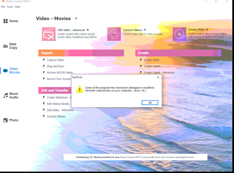

Some of the program files have been damaged or modified. Reinstall Videostudio on your computer [Error 38]

When starting Roxio NXT 9 "Edit Videos Simply" , the following error message is received.
Cause
This error normally happens when the license validation service has been stopped or disabled for some reason. Common causes may include 'system optimization' or antivirus/anti-malware programs which may identify this process as unwanted and disable it.
