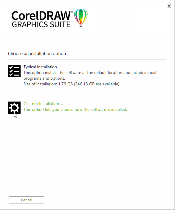

1. Start the CorelDRAW installation process and choose "Custom Installation"
2. This step is optional - Select the specific application you wish to install. All are selected by default.
3. In Utilities section, Untick the Box for "Visual Basic for Applications 7.1", and click on the "NEXT" button.
4. Wait for the installation to complete and then open CorelDRAW.
